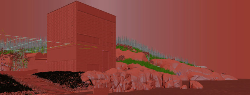

I’m done with modeling of the main building and all of the surroundings.

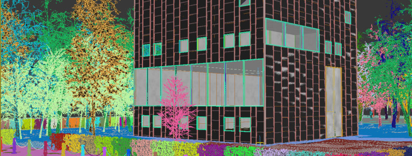

Glass material and reflections was the next important shader to recreate. As the panoramic window of “the white box” gallery is the focal point of my scene, shader needed to be interesting and replicated architectural glazing. To do that I assigned random ID’s to glass panes and created multi subobject with 4 glass materials. Each glass material had a noise mup in bump with different parameters for phasing. I have also turned on reflect double sided and used fog color and altered Max depth to 10. The indepth tips on that subject you can find on The Boundary website. I suggest you have a look and try, as it proved to be a very useful tip to replicate real architectural glasing.
When shading I always like to work with override material and only exlude parts which I am working on. As I go along there will be less and less parts excluded, and at the end I end up with the completely shaded scene. Working with override allows me to cut a bit of time during calculation phases.

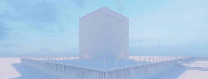

Few words about atmosphere. It was the first time me using environment fog directly embeded into the image , but I wanted to give it a try, due to the fact that my aim was to minimise post-production stage. I have used 2 fogs – general and 2nd closer to the building on box gizmo with noise to give it a bit more variation.

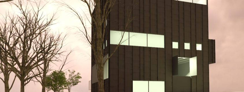

The general idea is to consider the building as a work of art and the final image has to tell a story.
So I used a long lens with DOF and I put the focus on the building to give importance to the subject.
The image has cold colors and a minimal environment in harmony with the architecture and the materials.
The only parts with warm lights are
the street lights of the walkway leading to the building and the interior of the exhibition halls,
like warm is the experience that visitors live in the museum.

I demonstrate my work looks like at the moment. Still a lot to do, I do not know if I have time to finish the job.
Almost done with modeling and texturing
