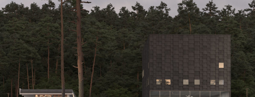

For the first time I tried something new. 3-Point-Lightning. It’s used for cinematic shots. I really want to achieve some kind of a cinematic atmosphere (like in my reference image – VPP Shelter box). I thought that could be the right choice, so I gave it a try.

It’s going to be simple. I want to focus on the main facade which faces the sea view (at the original site).
In addition, I will focus on the black facade which stands out best with a lot of contrast in comparison to the sky. Just like a cloudy windy white with a nuance of clouds.
To emphasize the cube as much as possible the cube is positioned in the middle of the canvas and surrounded by large pine trees and bushes.
To achieve depth in the image I’m using a few layers. Foreground with three trees, stones and all kinds of greens. In the middleground is the museum itself and the background is crowded with huge trees and bushes.
