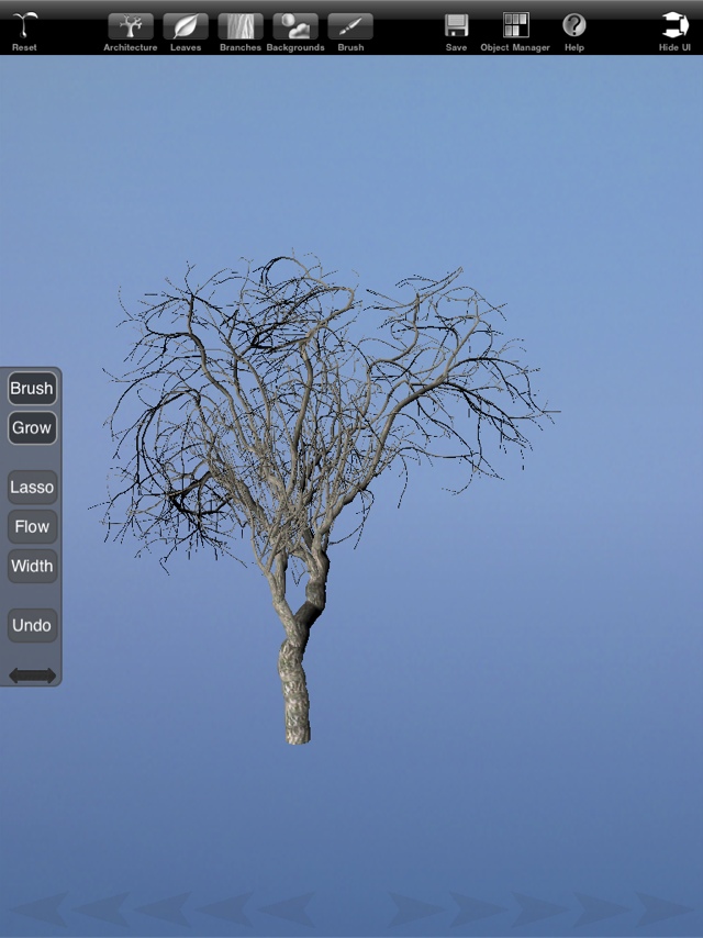

So… I been playing around with TreeSketch 2.0 and specifically started to use it outdoors – looking at tress and shrubs trying to remake them as I see them! It sure did spark a lot of interest among the crowd passing by 😉

By pointing on pivot points on branches, I was able to rotate/bend them over into a lower/drooped position that I was aiming for… this was super easy and very responsive – I did not have to think about any kind of parameters… just do what I like in a very intuitive way 😉

TreeSketch 2.0 exports to .FBX by the way – so you can use the models you create. If any of you already did so and have some examples. Please share them with us all 😉
